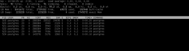

Hi Pierre,
Yes i see this Threads.
    16 KB · Visite: 12
